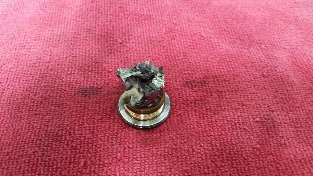

So, I just had the valves serviced a couple weeks ago, oil changed, belts replaced, dyno tuned. Last night while riding home, I noticed the bike felt under powered. I toggled to the oil temp and noticed that it was slightly above normal operating temp for the time (about 250, normally should have been about 220). Next thing I know, it starts bucking a bit like I lost power then got it back, the oil pressure light starts flickering and the top of the motor (?) starts getting loud, as in mechanical noise. I pull in the clutch and it dies. I coasted to a stop on the shoulder and the temp had risen to about 275.
Had my wife come pick me up, loaded the bike in the back of the truck. Dropped it off at the shop that did the work this morning.
What can I expect???
I started it up at the shop this morning. No oil pressure light, was a bit louder than normal, then noticeable mechanical noise when it was revved.
The switch for the oil pressure light opens at quite a low pressure, 3-4 psi IIRC.
Much easier to get that pressure with cold oil.
Well, the verdict is in. And not surprisingly, Nick was right. Ate a rod bearing.

39k miles. I do really like it. Just trying to be economical and realistic too. Wasn't exactly ready for a huge expense, especially after I just dropped the money on the service and dyno tune.
DS1k engines seem to be going for $1.5k and up.
That leaves a lot of room for a rebuild to be more economical.
Chances are good you'll need to replace the crank.
For a 2-valver, rebuild is a bit more with the newer motors, due to the head gaskets.
The only part of that service you've lost is the oil and filter.
