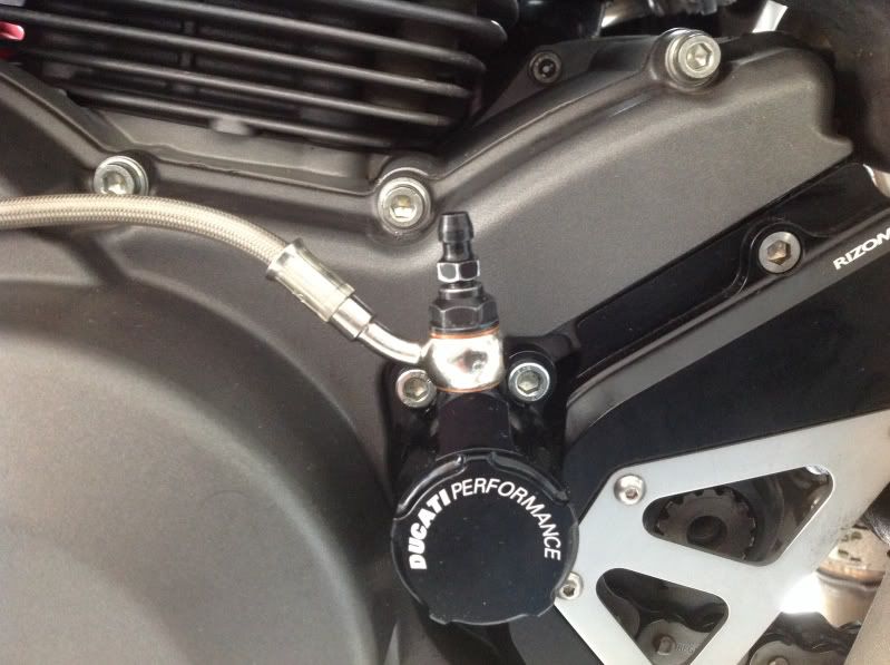

I'm using this slave cylinder.  The last time this happened I was convinced the bleeder was bad so I replaced it.  I'll be with the bike tomorrow and bleed the system.  Then I'll try to retrieve the codes.
