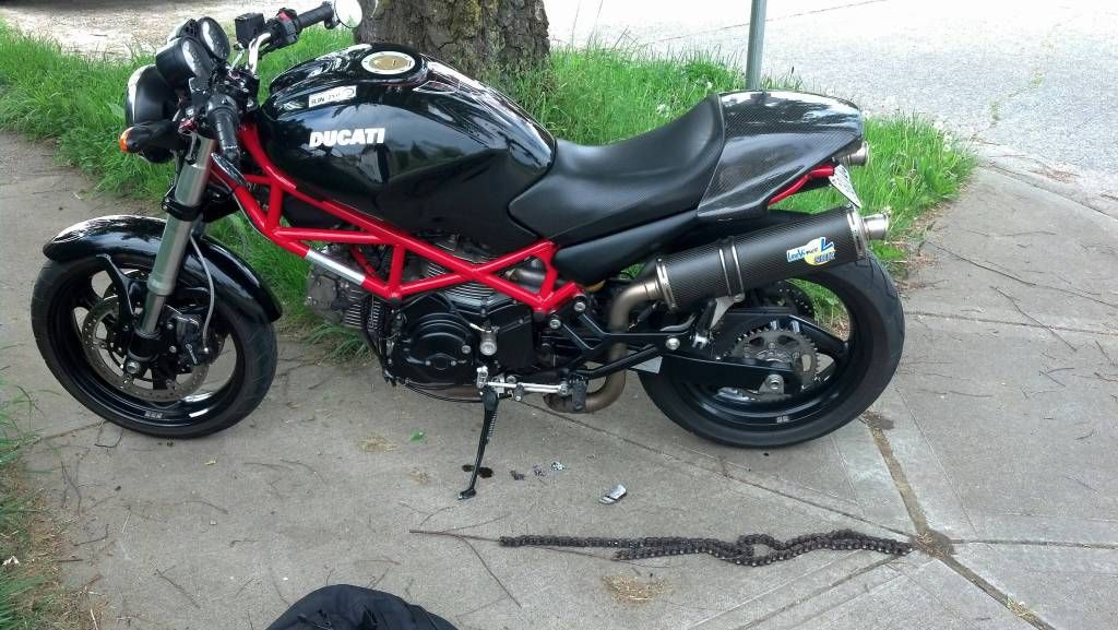

So i just got back from deployment onboard cvn 74 john c stennis and thought i would upgrade from my r6 to a ducati. So i bought an 08 monster 695 yesterday rode it back to base about 100 miles. Coming off base today i got on it grabbed second gear my chain snapped and wrapped up around my front sprocket causing my engine case to crack/break off a buisness card size hole in the side of my engine! Im confident mechanically but i need some suggestions. I dont think it can be welded.... but maybe it can. Let me know what you think! Thanks

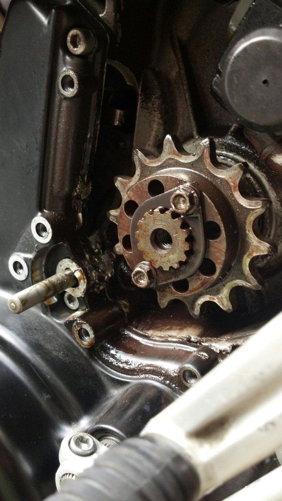

I will get some pictures up soon bike is at my buddies house right now. But basically the case above the front sprocket got broken off. The hole is about a buisness card big with another small hole below the sprocket. Anyone no of someone with extra case halves or maybe a whole new engine?

Oh man I hope you got a good deal.   So sorry to hear about the instantly broken bike.  Some lessons are very expensive, always check out a new used bike very thoroughly before riding it home.  The chain may have been super dry and kinking or it was super loose.
My Duc tells me when it is time to lube the chain........  Good luck finding a solution, I feel your pain.  :)

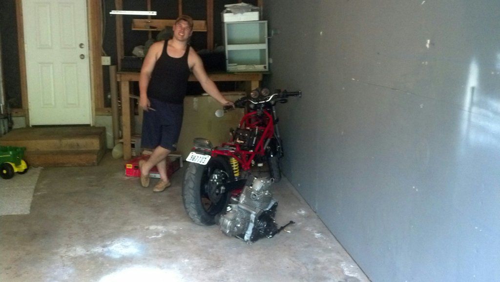

So I called around to some shops and they all said it be best to buy a new engine that weld up my case so I got one from a salvage company in California it only has 1132 miles on it and is guaranteed to run. Me and my buddy pulled the engine out yesterday this is the first newer bike I have worked on and it actually came apart real easy. I'll keep ya'll posted.

Hopefully the new unit comes with a clutch slave and push rod.  Looks like that region took a beating.
Obviously front/rear sprockets and a quality chain.  You had a 14T on there.  From scratch it's better to keep 15T and go +3 in the rear for the same overall gearing.  Chain is stressed less going around the larger 15T sprocket.

does that front sprocket look funky to anyone? alignment issue?
