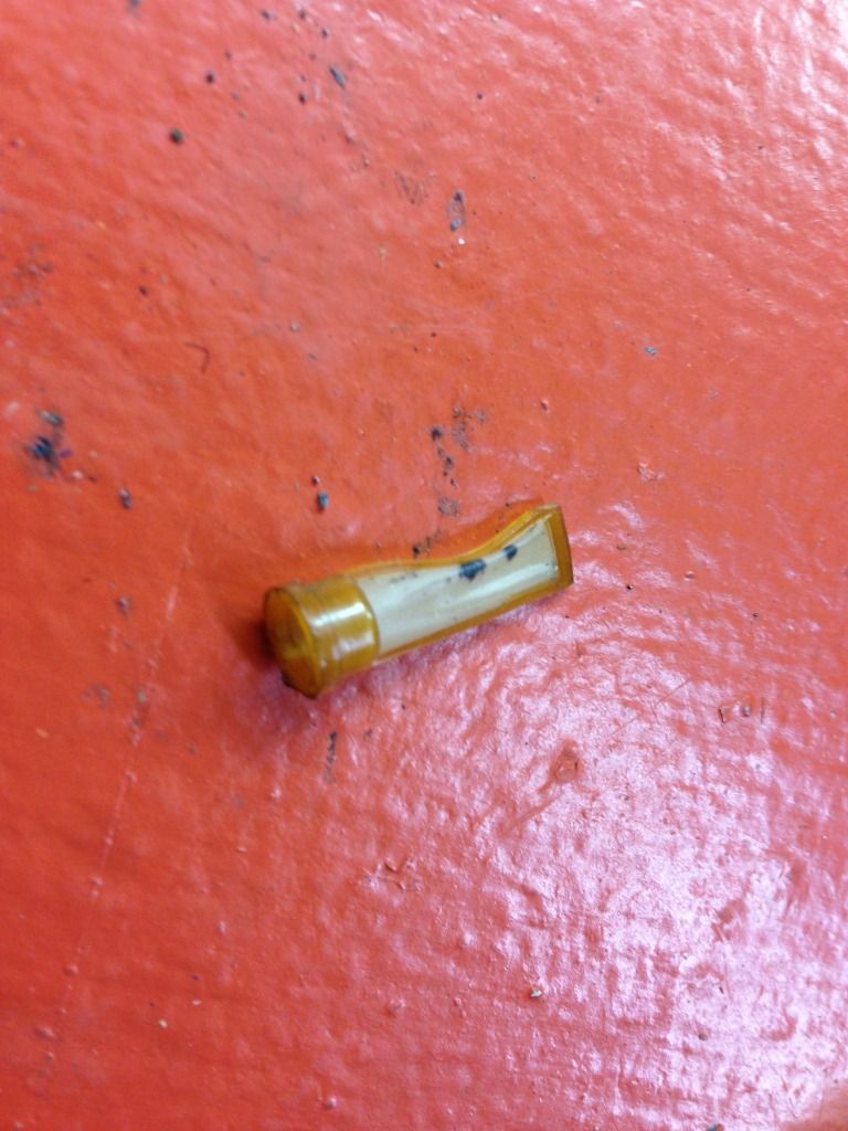

We were going to set gas tank back, when discovered that stop signal is not working. Rear and front stop levers don't change lightning. Rear light is constantly red. And there are no license plate light and middle headlight.
I assumed to start engine and check if stop signal works only when engine works, because I forgot how stop and static lights look like on my bike. But engine would not start! Starter is not working!
We checked fuses in the box they all ok. Fuses that stays close to relay are ok also. Relay is clicking at button press. I was pressing start randomly while mechanic was touching relay, starter and some other points, and bike started.
Mechanic assumed that contacts on starter are corrosed and he cleaned it. Bike would not start. Mechanic attempted to close circuit(with piece of wire) on relay and starter was attempting to work. So he assumed that relay is dead and not sending electricity to starter...
While he was checking rear break pedal for stop light button issue I turned on bike and started it without a problem. I tried to do it again and again and it starts with no problem, like nothing bad happened before.

Reading tech manual and deep forum search pointed me to these steps which I will follow:
Starting problem - Check all starting chain contacts. Check ground\frame connection. Check Kill switch contact.
Brake light - check brake button on rear and front brake manipulator [bacon]
Side\plate light  - check if there is short circuit with frame\ground.
I never found on forum that someone used capacitor for HIDs. So I will take them out.
FYI "relay" in my long story is "solenoid" or starter contactor.
Fuses were fine but now I am pretty sure that if I keep bike on little more or run it - some of them will die.

Well.
Brake light - problem was in foot control button. As it was released plate light got back ON.
Front side lamp just died and needs replacement.
Hid capacitors unistalled, Hid works fine.
Starting problem was not repeatable.. so just ended up cleaning all contacts.
