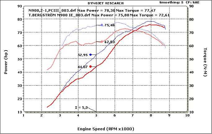

The graph below (hope it comes out readable) shows the same M900 MY 2002 with everything stock except Silmotor slip-ons (red) and homemade 2-1 as per above + open airbox lid and dynoe'd PCIII.
This happened before I had learned that owning a Duc means spending money, so I did not dyno the bike with the 2-1 system only. Would have been interesting, and worth the money.

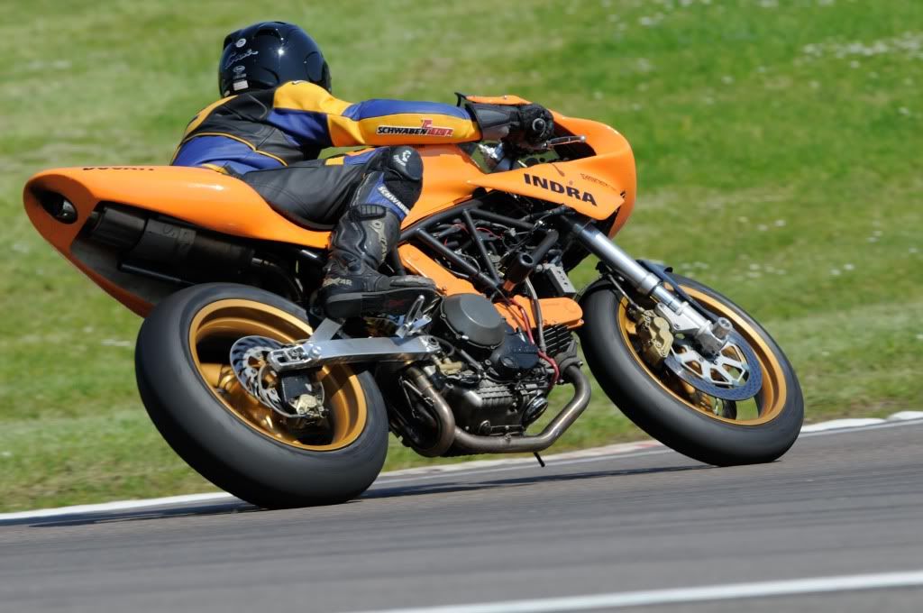

Well, ... this picture is the first "development prototype" and not very pretty, but it's the actual exhaust used for the dyno graph shown:
For our "rain bike", nominally for wet track days but actually used all the time by ourselves and everyone we know with  momentarily non-propulsive vehicles, we fabricated an exhaust with the aim of creating an exhaust that would be impervious to minor wash-outs but still designed along common-sense rules-of-thumb:
Instead of using the crude collector version shown in the first pic, this time we used a "Y" header connection to the collector, but the same header lengths (780 mm to 800 mm in this case). With no dyno chart to use as a proof, the general verdict from everyone riding this bike is that for a not-tuned (i.e., reliable ...) 900, it runs very well indeed. So far, it also tends to run when other, more "tended-to" bikes do not .... and since the verdict is mostly from people with bikes not running at all, maybe it's not very neutral.
