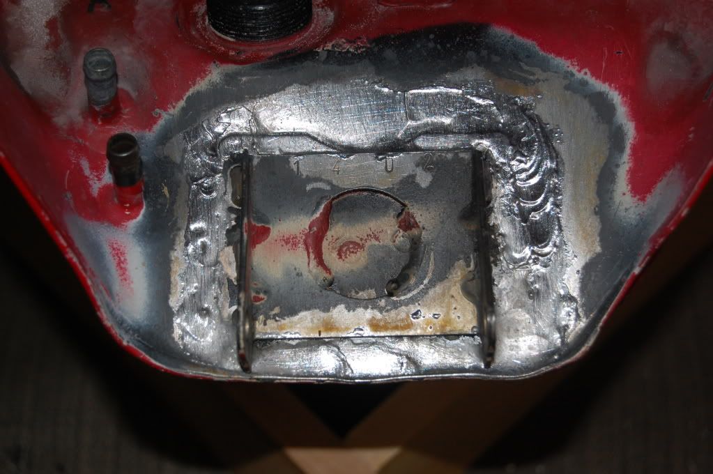

MonsterHPD
My daughters have always commented on how much they like the smell in our garage (where our cars have not been in at least 10 years  ;D ).
Last fall I had the feeling that the gasoline component of this garage smell was getting increasingly dominant. Since the lawn mower did not smell any worse than usual, Ol'Faithful seemed the likely culprit.
Having had advice from THE source, and after checking the alternatives, the hinge bracket seemed to be the culprit.
Using a hot air gun, and a monstrous soldering iron inherited from my granpa, this is what I did using body soldering tin bar (or whatever that's called in english).
So far, it's been tight for about 5 hours ...  [roll]

Quote from: MonsterHPD on February 25, 2012, 02:36:32 PM
Nice work.
That will work as long as you don't stress the hinge again and crack your solder job.
