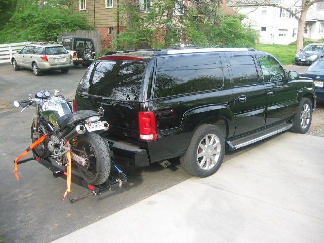

This is Yuus old hitch hauler.  Ive used it several times mainly to take the bike in for service or for a trip to the beach.  Works great with load leveling suspension.  My Avalanche that doesnt have L.L. suspension sags quite a bit.  Surprisingly stable but takes a little while to get used to.

My Suburban is a 3/4 ton with the 8.1L so the truck is no issue. I just wasn't too sure how stable the rack was with a street bike on it. Thanks for the info and the picture. Yeah, that bike looks good.

Quote from: rgramjet on January 29, 2009, 03:08:43 PM

Quote from: kawazar on January 29, 2009, 03:36:18 PM
I adore that 8.1.  My previous Avalanche had one in it with 4.10 gears.  Got 11 mpg no matter where I went or how fast I went.
